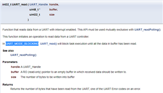

I have found references about UART_MODE_CALLBACK atribute on Texas Intruments documentation. However, in SDK 03.05.00.04 it is only explained the blocking mode:
Is there any way to perform non-blocking readings in SDK 03.05.00.04?
Moreover, in the documentation is explained something related to an interrupt: "Function that reads data from a UART with interrupt enabled". Which is this interrupt?

    Regarding your question, I need a non-blocking UART because my program do more tasks than reading from de UART. I started from SRR example and now I have to read from the UART to get some information. Considering the second question, I am not encountering errors, but I do not want to wait until fill the buffer to do the rest of the task, maybe puting this reading in a separated task, it could be a better approach?
    The problem that I see with UART_read() or UART_readPolling() is that you will wait until you fill the buffer or you receive the new line character, and if there is any problem in the communication bus you will be blocked for ever. Can be configured any timeout policy?
    I saw the non-blocking implementation here but It looks like for other HW.
