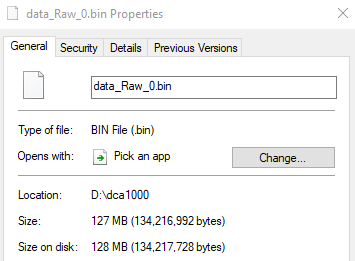

  • With 512 samples and 50 ms frame time, I have exactly the same issue.
    I don't find the "maxRecFileSize_MB" option or anything similar in radar studio.
    Could you please post a screenshot of your captured bin file like the one below?
  • HI,
    The maxRecFileSize_MB for radar studio is configured inside cf.json under the C:\ti\mmwave_studio_02_01_01_00\mmWaveStudio\PostProc\.
    Not sure it can be modified.  But you can check to see whether the size is matching with the value inside cf.json.
    My size is the same as yours.  It should be good then.

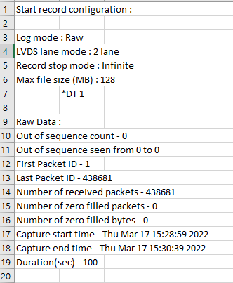

  • I have also check the log file that saved together with the bin file.   I see there is some package loss and filled up with zeros.
    Raw Data :
    Out of sequence count - 2
    Out of sequence seen from 455588 to 455602
    First Packet ID - 1
    Last Packet ID - 488819
    Number of received packets - 488798
    Number of zero filled packets - 21
    Number of zero filled bytes - 30576
    Capture start time - Fri Mar 11 17:01:45 2022
    Capture end time - Fri Mar 11 17:03:16 2022
    Duration(sec) - 91
    Do you want to send me your log file.
    Zigang
  • I don't have zero filled packets.
