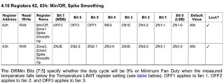

Customer has some questions regarding the setting of REG62 bit 5~7.
Referring DS spec, the FAN speed will be 0% if REG62 bit5~7 are set to 0; or minimum fan duty decided by REG64~66 if REG62 bit5~7 set to 1. However, customer found whether REG62 bit5~7 set to 0 or 1, fan speed would always be affected by REG64~66.
Could you please clarify if there are any other things need to pay attention or suggestions?
