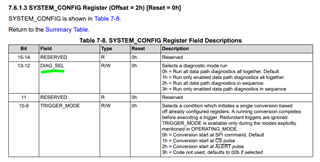

    In regards to question #2, does enabling the diagnostics (SYSTEM_CONFIG.DIAG_EN) increase the device power consumption? Maybe it's in the ISO document, but is it expected that the device will always be operated with diagnostics enabled?
  • David,
    The major concern with adding in the diagnostics will be the additional time to allow for those to complete.  During the diagnostic checks there should be no increase in current.  The primary current draw for this device occurs while the device is actively converting using the Hall-elements.  The default condition for the device is that that the AFE diagnostics set by DIAG_EN are disabled:
    Diagnostics are optional, and not needed in all applications.  They should be enabled when trying to design towards ISO26262 standards, however.

  • I finally got approved for the ISO26262 document and it does, indeed, answer my questions. Before I mark this thread "resolved," let me submit a few comments for other TMAG5170 users who may be wondering the same things.
    • If you really need super-reliable operation and want to use the diagnostics in this chip, register to get a copy of the ISO document.
    • The AFE diagnostics can significantly increase the sampling time. If you're not prepared to handle the diagnostic failing, I would suggest running with SYSTEM_CONFIG.DIAG_EN set to zero. If you are still interested in the diagnostics, run with SYSTEM_CONFIG.DIAG_SEL = 0b1x. This will only add about 20-25 µs to the conversion time for each conversion set.
    • The AFE diagnostics perform many ADC conversions as well as increasing the conversion time so the power consumption is definitely higher.
    • It seems like a suitable POST procedure would be:
      • Read and write the DEVICE_CONFIG register and verify that you can access the registers.
      • Test the oscillator
      • Perform one magnetic sample with diagnostics enabled. This will ensure that the analog circuitry is okay (at least on power-on). If you set up the chip to interrupt on sample complete (ALERT_CONFIG.RSLT_ALRT is set), then you can check the INT pin state.
