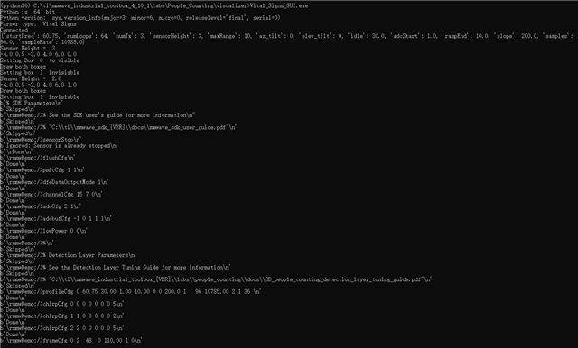

    According to your advice, I have modified the parameters (0 61 500 7 20 0 0 100 1 64 5333 0 0 48) of profilecfg command in the xwr1642_profile_VitalSigns_20fps_front.cfg file based on my understanding. Unfortunately, there are not any improved sides to the issue. So would you mind giving us more information about how to modify the parameters? Can you offer some parameters of profilecfg command to correct the issue?

    3D People Counting With Vital Signs lab demo has been set up for testing. Details are as follows:
    1) lab demo version: C:\ti\mmwave_industrial_toolbox_4_10_1\labs\Vital_Signs\3D_People_Counting_with_Vital_Signs
    2) platform(two mode): IWR6843AOP EVM / IWR6843AOP EVM + Industrial mmwave carrier board (switchs have been set correctly)

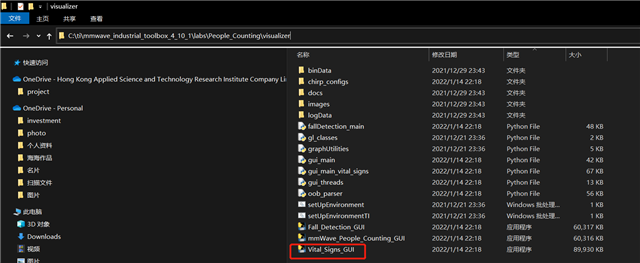

    3) GUI version: C:\ti\mmwave_industrial_toolbox_4_10_1\labs\People_Counting\visualizer\vital_signs_gui

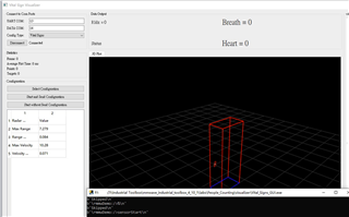

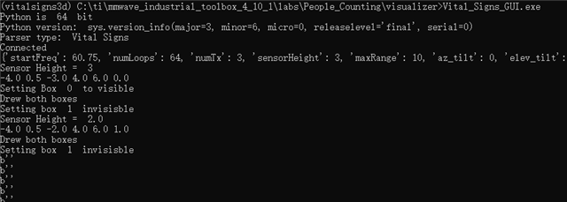

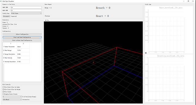

    when the GUI is running, The com ports can be connected and cfg parameters can be sent. but there are not any informations in the statistics area. Please give us some advice on the issue. The issue is the same when GUI is running in the IWR6843AOP EVM standalone mode and EVM with mmwaveICBooset attached. Thanks!

    • Do you have teraterm or any other programs open that might also be connected to these com ports?
    • Did you move the device into functional mode?
    As for question 1.. I think it will be best for you to compare the performance of the two labs yourself and then focus on perfecting the configuration parameters.

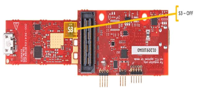

    • Did you move the device into functional mode? (S3 Switch is off status -function mode no flash mode)

  • Hi Thomas,
    Ok! Thanks for checking those things. Another thing we can check, after b'\rmmwDemo:/sensorStart\n' did it print another line stating "Done" or "Sent" in the python CLI?
    Thank you,
    Angie

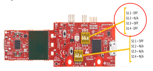

    But I want to try the set-up of the lab demo only using the IWR6843AOP EVM (standalone mode).  there are some following errors during the parameters configuration.
    Please help me confirm that Can I do the lab demo only using the IWR6843AOP EVM with standalone mode. if the answer is yes, How to fix the above issue? Thanks!
    Thomas
  • Thomas,
    I am so glad you got this to work! Yes, you can run this lab demo in standalone mode. The issue above can happen if the device was not properly moved to functional mode and then reset with the NRST button before sending the configuration file.
    Please try one more time and make sure you have the switch on the back of the AOP moved to it's functional mode setting and press the NRST button before sending the config and see if this works.
    Angie
  • Angie,
    I'm so glad that the demo is running successfully  Based on IWR6843AOP EVM with standalone mode. The S1 switches should match the following image.
    Thank you a lot!
    Thomas
  • Yes, and the switch on the back of the board needs to be on when flashing and off when running the demo.
    Angie

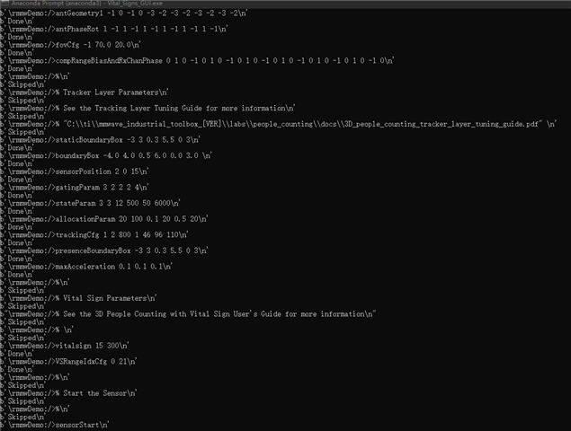

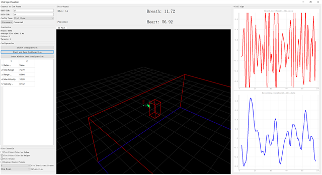

  • About 3D Vital Signs, sitting 40cm before the sensor. My heart beat is sometimes over 90,however the testing result is low. How to configure or set up to make the result more reasonable
     part of content in config file:
    staticBoundaryBox -0.6 0.6 0.3 1 0 3
    boundaryBox -0.6 0.6 0.3 1 0 3
    sensorPosition 0.86 0 0
    gatingParam 3 2 2 2 4
    stateParam 3 3 12 500 50 6000
    allocationParam 20 100 0.1 20 0.5 20
    trackingCfg 1 2 800 1 46 96 110
    presenceBoundaryBox -0.6 0.6 0.3 1 0 3
    maxAcceleration 0.1 0.1 0.1
    vitalsign 15 300
    VSRangeIdxCfg 0 21
  • Angela,
    I would start by playing with your vitalsign 15 300 command. 15 is the refresh frame rate and 300 in the window size.
    Refresh frame rate is how often you are doing vital signs processing. Decreasing this will mean the program calculates heart rate more often and will give you better data in real time but will use more MIPS.
    Window size is how many frames of radar data the program uses to make a decision on heart rate and breath rate. If you increase this you may need to also increase your frame rate (in framecfg) but you may also see more accurate data.
    Angie

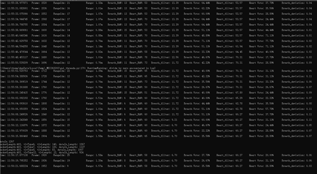

  • Angie,
    I update 2 parameters of vitalsign, it works.
    But  when I updated  frameCfg, after sending config file to sensor it cannot continue to work.
    How to update frameCfg correctly?

  • Angela,
    With the increased window size you will need to increase the frame rate to above 110. Try 150 and if that does not work go higher.
