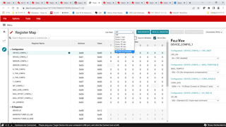

2. Regarding GUI of EVM, what does "As fast as possible" mean? (Please see below picture. It is located in top of center.)

    "As Fast as Possible" sets the GUI to repeatedly send read commands to the MCU.  The MCU then executes the read and sends this back.  This is not the same as the maximum I2C read rate for the device.  There is a significant delay in communication sending and receiving one byte packets.  Future GUI updates are planned to communicate this data in a larger bulk packets that will better demonstrate the maximum sample rate of the device.
