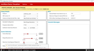

We have an issue on mmWave_demo_Visualizer v3.4.0 with below FW ;
C:\ti\mmwave_industrial_toolbox_4_7_0\labs\out_of_box_demo\68xx_mmwave_sdk_dsp\prebuilt_binaries\xwr68xx_mmw_demo_bin
It seems UART connection is always failed with our original evaluation board, as shown in attached file.
We suppose that another interfaces like I2C are tested for checking the connection.
We would like to know which interfaces are used for it.
Taka

  • Dear Brennan,
    We are testing in functional mode. It seems visualizer app may send some commands to IWR6843 through UART during the connection check
    and then something may be checked by IWR6843 and replyed to the App.
    We would like to know what is checked by IWR6843.
    Taka
  • Taka,
    I notice that in the screenshot you provided, you have not set the correct device in the Setup Details window under Platform.  Be sure that this is set to the device you are using (in this case, xWR68xx):
    This should solve your problem and you should now be able to successfully connect, given that your device is in functional mode.
