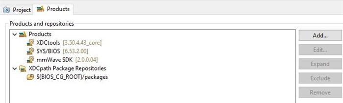

We wanted to debug the Out of the Box Lab from Indutrial Toolbox 4.10.1 in the evaluation board AWR1642-BOOST. We have been following the steps in CCS and when we rebuild the DSP project it shows some compilation errors.
We have installed the required SDK version and tools.
Any idea why this is happening?

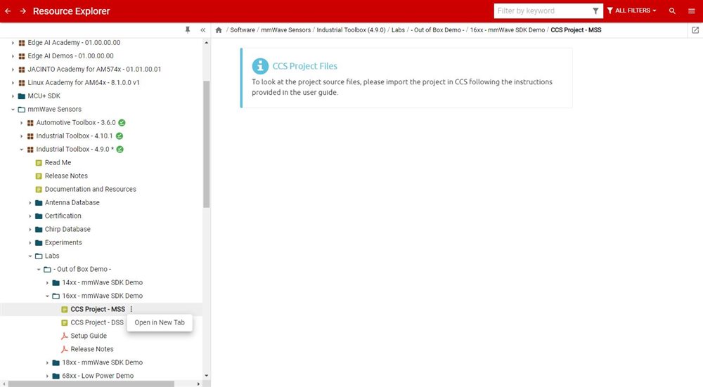

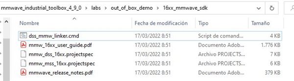

    Thank you for the fast response!
    It seems that in Industrial Toolbox 4.9.0 neither comes with the project files.
    Is it possible to import it to CCS from the mmWave SDK? Or is there any user manual about how to setup the SDK demo in CCS?
    Thank you in advance!!
    So for the Industrial Toolbox typically ships projectSpec files rather than project files. They are very similar, except a project file is typical a copy of an environment we have set up on our systems VS a projectspec is more similar to a recipe to set up the environment on your system. If you are in CCS, just go to import->ccs projects and navigate to the folder you showed above, and you should be able to import the demo. Let me know if you have any further issues.
    Alec
  • This worked, I imported the project like you said.
    Thank you very much!
