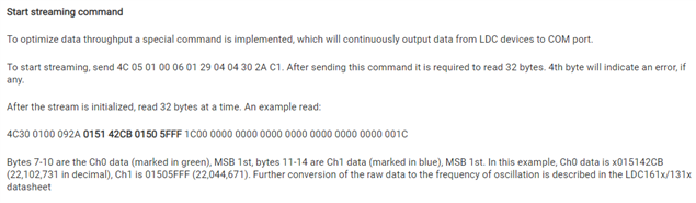

I am currently integrating FDC2214EVM sensor plate connected to PC via USB and I am manipulating the board with Python v3.0 script that I found on github (https://github.com/mitmedialab/TI_EVM_logger/blob/main/evm_logger.py).
Everything works fine and I have succesfully changed the script to suit my needs but I have a question, because I don't understand completely how the command '4C0501000601290404302AC1' is formed to communicate with FDC2214EVM.
Does anyone know how are this and simmilair commands formed.
