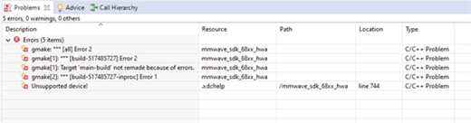

    and after we clicked "Rebuild project" on "mmwave_sdk_68xx_hwa" we faced this CCS error (screenshot attached).

    2. 2. We followed the steps described here: dev.ti.com/.../node
    and after we did "Rebuild project" on "mmwave_sdk_68xx_hwa" and after triple check, we performed all requirements we faced the attached CCS error.
    How to solve it?

    For the build errors, this could be a few things.
    1) DId you modify the source code at all? If so, please try reimporting and building without any changes just to test the build environment. But I think this is already likely the case.
    2) Are you sure the XDC tools is downloaded properly to that folder and that it is installed in CCS in the window>preferences>code composer studio>products window.
    Jackson

    4. About the buiId error- I did not modify the source code at all and I think the XDC tools is downloaded properly, take a look in the attached screenshot

    4)Can you confirm which version of CCS you are using? Also, after building are there any errors in the problems window in CCS? Or are the log errors the only ones? Can you please send the entire error message? The screenshot only has some.
    Jackson
  • Hello Jackson,
    Please see my customer response below:
    The console window and the problems window are attached
    Renan
    I see now, I didn't realize you were building the auto toolbox projects. Those have an issue and are broken right now. Please use the OOB demo from the industrial toolbox, those will build. The documents may indicate IWR6843, but the projects will work exactly the same for the AWR device.
