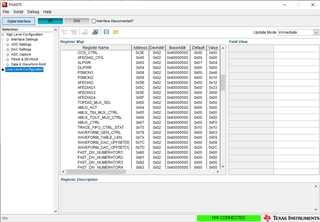

I just started working with the PGA970EVM board and initially the board was generating waveform at PI (TP16) with no LVDT attached.  I was able to change the frequency so I know the SPI interface was working.  After a power down/up of the board, the waveform is no longer being generated.  Just getting a flat line at TP16.  Tried different waveform generator setting but no difference.
Measured board voltages are shown below.  I notice REFCAP (TP17) is 0 volts, not sure what it should be?

    Did you make any other changes to the FRAM in the meantime, like programming your own firmware into the device? Or was the only change made to the waveform data, which initially worked, and did not after restart?
    Scott
  • Hi Scott,
    Only made change to waveform data.   Really just started working with the board, was able to generate the waveform and change the frequency and see it on my scope (PI), then lost it after power up.
    Is there way to tell if FRAM got changed/corrupt form default?
    Chris

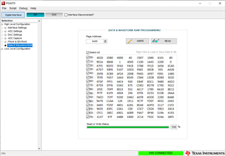

     waveform registers values
  • Hi Chris,
    You can check the waveform RAM data from the Data & Waveform RAM page, but unless you have the original one to compare against it might not be helpful. You can at least see if it's pulling the data from the FRAM properly.
    Scott
  • Hi Scott,
    The Data & Waveform Ram did populate with values when read.  As you said, not sure what the values mean or correspond to.
    Would you recommend loading new HEX file to the FRAM?  If so, is there a generic HEX file I can download or generate to use?
