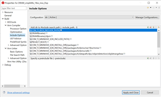

I'm writing my own code, based on 18xx OOB demo from the HTB & SDK.  As in the docs, I'm copying bits (e.g. from SDK) to a new location so I can rename/change etc without affecting the originals.  I'm at the stage where I need to make things tidier, so have 2 questions. NB this is a CCS 11.1 query, rather than IWR.
1)
How do I make a "path shortcut", like the <ti/pakages> construct used in #DEFINE statements?  I want to make something like a "myLibs" to replace e.g. "C:/a/b/c" etc.  I've managed to add "preferences:build:environment", but that doesn't seem to be how its done, or at least it doesn't work and I get "can't find path" errors at compile time.
2)
Similarly: if I put new files (*.c) in the project, then all OK.  However, I want to put everything in libraries - just as files fetched from within the SDK, where they're not explicitly mentioned/called in the project, so presumably there's a "path" or similar mechanism to do this?  I have things like the functions are mentioned as EXTERN in the .h file included in the main code.  Accessing the .h seems fine.
I have managed to add the relevant path into "properties:compiler&linker" flags but, again, this doesn't seem to be how its done - I get linker errors for un-resolved symbols for the functions etc defined in the (now in a separate library folder) .c files.
Maybe these sorts of things are covered in some on-line training?  I've see the getting started guide, but I'm getting deeper in bow.

    1)
    I believe you are referring to build variables:
    https://software-dl.ti.com/ccs/esd/documents/ccs_portable-projects.html#variables
    You can create build variables that point to a directory and then use the variable in your build options - such as youe include search paths or library paths
    2)
    You mentioned libraries. You can create a library project that will generate a C library that you can reference from your main project by specifying the path to it in the linker options.
    I suggest talking a look at Chapter 6 of the CCS User's Guide:
    https://software-dl.ti.com/ccs/esd/documents/users_guide/index_project-management.html
    Several sections in there should contain the information you are looking for.

  • #include <DRAMlibraries/cmplxmix_Mss/cmplxmix_Mss_Dsp.h>
    Oh I see what you want to do. My apologies, I misunderstood your use case. You want to create define a variable to use in your actual source code, not in the project settings.
    The technique I suggested is for variables to be used in the project settings.
    To use variables in your source code, you'd probably want to define a preprocessor macro
    But I'm not sure if the compiler supports trying to use the macro in a #include. I would need to check with the compiler experts.
    ki
  • But I'm not sure if the compiler supports trying to use the macro in a #include. I would need to check with the compiler experts.
    I confirmed that this would not work.
    The best is to specify the DRAMlibraries build variable in the compiler --include_path option and then specify:
    #include "/cmplxmix_Mss/cmplxmix_Mss_Dsp.h"
    ki

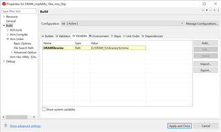

  • Hi Ki,
    no problem, can be easy for words to mean different things to different people ... would be much easier if we could sit in front of the project with a coffee!
    I'll look at include_path and see what I can manage.  If nothing else, I'd have thought that I may be able to "decypher" the syntax already used i.e.:
    <ti/demo/xwr18xx/m...   format, and see how the "ti" bit of the path is defined somewhere in preferences or properties - so I could copy the form, but I haven't actually seen that.
    There was the second part to my question, perhaps more on how you were originally thinking: how do I specify where files are, so compile & link can find them - i.e. when say .c file is in a library somewhere, as opposed to in the project itself.  Again, I've been trying the various things I can find for paths, file locations etc in preferences and properties, but so far without success.
    I get the "unresolved symbols" error, for names in the various .c files - I'm not sure if this is just at link time, or whether the compiler hasn't found them either.  For completeness ... this all works if I put the files in the project, so all the other mechanisms e.g. EXTERN etc seem OK, its just that the build can't find the libraries.
    many thanks
    Alan
  • Hi again Ki,
    success on the first part!  Rather than trying to define my own "path name" i.e. DRAMlibraries = something then include <DRAMlibrarie... ,use the properties:compiler:include pathe etc setting, then #include, but without the "front bit" of the path, this being supplied via properties.  Got it!
    Always the problem when delving deeper into how tools work: you have to know how it wants you to ask the question, which affects what the answer is .... all part of the tool training the user!
    Just need to sort out compile/link with files in libraries, an I should be ready to go.
    thanks
    Alan

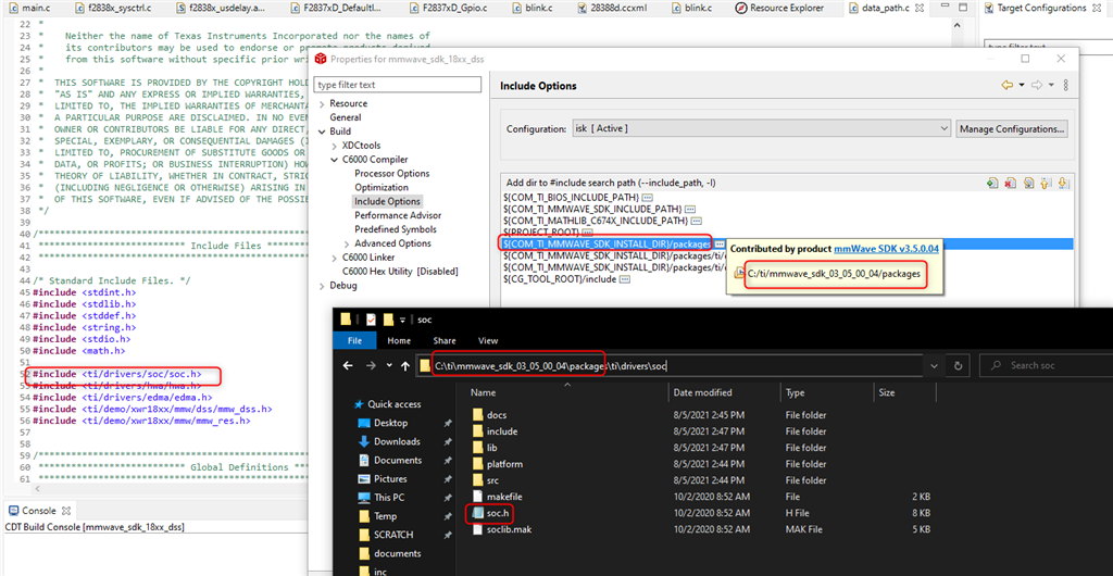

  • <ti/demo/xwr18xx/m...   format, and see how the "ti" bit of the path is defined somewhere in preferences or properties - so I could copy the form, but I haven't actually seen that.
    "ti" is just a folder. It is the start of a relative path.
    For example, lets look at the below:
    In the Include Options, there is the below path:
    ${COM_TI_MMWAVE_SDK_INSTALL_DIR}/packages
    COM_TI_MMWAVE_SDK_INSTALL_DIR is a build variable that is set to whatever the mmWave SDK intall directory is. In my environment, it is:
    C:/ti/mmwave_sdk_03_05_00_04
    Hence the include path expans to:
    C:/ti/mmwave_sdk_03_05_00_04/packages
    Now lets take a look at the below include statement:
    #include <ti/drivers/soc/soc.h>
    We can see that soc.h resides in:
    C:/ti/mmwave_sdk_03_05_00_04/packages/ti/drivers/soc/soc.h
    Since we already have C:/ti/mmwave_sdk_03_05_00_04/packages in the include search path, we can just use a relative path from that directory. Something like: "ti/drivers/soc/soc.h". Or:
    That is why the above include statement works.
  • success on the first part!  Rather than trying to define my own "path name" i.e. DRAMlibraries = something then include <DRAMlibrarie... ,use the properties:compiler:include pathe etc setting, then #include, but without the "front bit" of the path, this being supplied via properties.  Got it!
    Ah you already figured it out. I should have read your second post before replying to your first.
    Anyway glad to hear you got it working now!

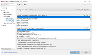

  • Hi Ki,
    great answer thanks - I may be getting the hang of this now.  So, I've tidied out everything I tried before, and added my library as a build variable, then using this to set the PATH details for both the compiler and linker ... assuming that's how it finds everything. This looks llike:
    I've also added paths for the next level of the library i.e. dpm (where I'm working at the moment). This seems to be how the rest is done, i.e. I can't just specify the "start" of the path, I need explicit entries for each sub level?
    Presumably I've still got something wrong here, as I'm still getting messages for unresolved symbols - those in my dpm library & file.  As said, this works OK with the dpm.c file IN the project, but not once I've moved it out to a library.
    Something more I need to understand, I presume?
    many thanks
    Alan

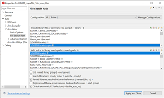

  • I've also added paths for the next level of the library i.e. dpm (where I'm working at the moment). This seems to be how the rest is done, i.e. I can't just specify the "start" of the path, I need explicit entries for each sub level?
    Yes. The compiler/linker does not do a recursive search (i.e. does not look in all the subdirectories)
    How are you referencing the actual library file in your project? Did you explicitly add it to the project? Or did you add it to the --library list?
    ki
  • Hi again Ki,
    this is where learning the exact terminology used by the tool becomes important, so I can give you the information you need...
    As per our last mail, I had added my paths by putting them into the compiler & linker include options & search paths, NOT  the linker library area (hope this shows on previous screen shots).
    I've now added into the linker library bit ... and for some reason, I get a different response today: adding the library by selecting the variable was OK, but when previously I had tried the EXTEND option to add the sub-directory, it came up with an error "has to be in ?? format" - of course it hasn't given me the error today so I can't tell you exactly what it was!  Obviously, I've change or corrected something else in the meantime.
    OK - so I've got entries under LIBRARIES - but now rebuild fails saying it hasn't got permission to read the directory, error 6001.  Interesting, as I know it can access the files to compile the .h's.
    I hope that answer what you're asking re project & library additions.  In chapter 6 of the docs, it also talks about resource:linked resources - in case that's where you mean.  I can add the library here, but it doesn't fix the problem.
    many thanks
    Alan
  • I see you added ${DRAMlibraries} and ${DRAMlibraries}/dpm to the --libraries options. Those are simply directories, are they not? Note that this option is looking for the name of the actual library file and NOT the path to it
