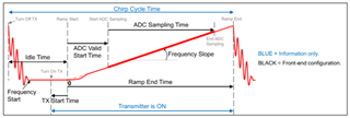

I have a question to the following figure.
The ADC sampling time is not defined in the profile configuration of the radar.
1. Is it correct that it is the result of equation 1/digOutSampleRate * numADCSamples?
2. If 1 is correct, what would happen if the Ramp End Time is set shorter than the End ADC Sampling time ?
    1. Yes, ADC Sampling Rate can be determined by calculating (Number of Samples)/(Sampling Rate) which is represented by the inputs (numADCSamples)/(digOutSampleRate).
    2. Ramp End Time must be set to be greater than the sum of ADC Valid Start Time and ADC Sampling Rate. That is rampEndTime > adcStartTime + (numADCSamples)/(digOutSampleRate)
