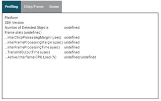

Hello, I have a question on Visualizer.
Edit the cfg file profile_3d.cfg in C: \ ti \ mmwave_sdk_03_05_00_04 \ packages \ ti \ demo \ xwr18xx \ mmw \ profiles
It was loaded by [LOAD CONFIG FROM PC AND SEND].
Changes
channelCfg 15 1 0
(Only one transmitting antenna is valid)
However, then nothing was displayed on the horizontal plot screen.
Is there any cause?
(See figure)

  • Hi
    Does the visualizer work without the changes to the profile file?
    Do you see in the visualizer if the commands are received by the target?
    Thank you
    Cesar

  • Hello, I'm sorry for the late confirmation.
    Looking at the console screen, I think it is reflected.
    mmwDemo: /> channelCfg 15 5 0
    Done
    I felt that another cause was that the Profile tab part was Undefined.
    Please reply.

  • Hello, the connection between Visualizer and AWR1843 Boost is slow depending on the day.
    (If it is long, even if you wait 10 minutes or more, the connection will be displayed.)
    I think it is due to the setting of Serial Port Configuration.
    For the time being, I connected the port numbers as instructed in the User Guide.
    At this time, does the baud rate of Device Manager (UART on the PC side) need to be the same as the baud rate set in Serial Port Configuration?
    Also, if there are other causes, please let me know.
    This is very strange. I never experienced such low communication between visualizer and target.
    The baud rate used on the PC must be 115200 for Application UART and 921600 for Data UART
    Thank you
    Cesar

    I think that the problem is not with the configuration. The problem is the UART connection with visualizer.
    I will test this on my side. I recommend that you try another computer if possible that supports 921600.
