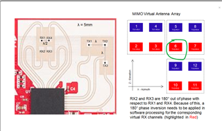

Is the antenna number marked in the screenshot correct? Should it be TX2-RX2?
Hi Nancy,
Sorry for the delay due to weekend break.
Yes, this looks like a misprint/typo. It should be TX2-RX2. Thanks for pointing this out.
Can you send us the source of this snippet so that we can take action to correct this?
