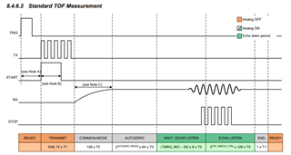

    Thank you for posting to the PS forum. The TOF_0 register is a configuration register for the listening window on the device. TDC1000 does not actually provide a ToF, it provides a START and STOP pulse that can be timed used a microcontroller or a timer like TDC7200. TOF_0 register is used to configure TIMING_REG so that you may configure the echo listening window. I have provided a diagram below, you can see TIMING_REG is part of a formula and not a results register.
