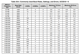

  • Hi Pejman,
    At higher baud rates, you can be more likely to get transmit and receive errors.  As an example, here is a snippet from a microcontroller user’s guide that shows how the UART TX and RX errors can increase at higher baud rates for that specific microcontroller family:

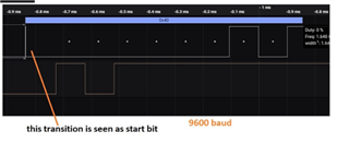

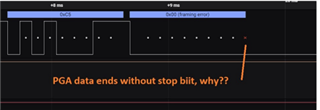

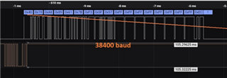

  • This is the snapshots using logic analyzer. The start bit from PGA460 is too short.. Diagnostics byte is always read as 0x40 by logic analyzer. I think the microcontroller I use has problem detecting this narrow start bit. Why the pulse width of PGA460 is too narrow? Why it does not keep its TXD line at logic one level so the start bit at the start of transmission could be detected properly by the master?
    My question is "how to configure PGA460 to keep its UART TXD "High" when it is in idle mode?

  • Hi Mekre, thank you. I did pull up the TXD yesterday with 10K and it fixed the issue. Your suggestion is absolutely correct.  As the TXD is 'low' in idle, when PG460 sends data and communication starts, there is a very narrow pulse which the master  cannot see as a start bit. When the controller communicates at higher baud rate, it seems it can see the transition as it is prepared for sampling the line for start bit faster.  After 0x40 , the next byte is 0x19, if controller does not see the start bit, it sees the transition at 8th bit of 0x40 as the start bit.  00000010. The next byte is 0x19 -10011000. There are two stop bits from PGA . So the sequence is 0000001011010011000. What the master sees is 11010011 or 0xEB instead of 0x40.
