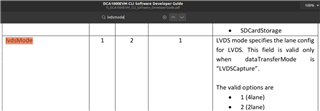

  • Hi Miao,
    Lane configuration needs to matched for AWR device as well as for DCA1000EVM.
    In above  mmwaveconfig.txt configuration file: laneEn=15;  means all four lanes are enabled for AWR device, i.e. ADC data will be streamed over all four lane of LVDS.
    Now same setting should be set with DCA100EVM
    To capture DCA1000EVM data you can optionally use command line tool available under mmwave Studio installation
    C:\ti\mmwave_studio_02_01_01_00\mmWaveStudio\PostProc  -  DCA1000EVM_CLI_Control.exe
    User guide for this exe is available C:\ti\mmwave_studio_02_01_01_00\mmWaveStudio\ReferenceCode\DCA1000\Docs\TI_DCA1000EVM_CLI_Software_UserGuide.pdf
    Search 'lane' in this document to find relevant information. And preferably go over full doc
    Jitendra

    I have tried to capture 2-lane option with DFP example and here are my observations
    1. [4 lanes] Tried first with default application c:\ti\mmwave_dfp_02_02_03_01\ti\example\mmWaveLink_SingleChip_Example  [change frame count frameCount=100;  in mmwaveconfig.txt  single change] and in parallel run c:\ti\mmwave_studio_03_00_00_14\mmWaveStudio\PostProc\DCA1000EVM_CLI_Control.exe tool to capture the LVDS data
    Ran first these two commands :  DCA1000EVM_CLI_Control.exe fpga cf.json  and DCA1000EVM_CLI_Control.exe start_record cf.json in one command prompt.
    Then ran C:\ti\mmwave_dfp_02_02_03_01\ti\example\mmWaveLink_SingleChip_Example\mmwavelink_example.exe
    After this exe ran, it gave me 50MB adc_data.bin file at mmWaveStudio\PostProc\  directory
    2. [2 Lanes] Now changed laneEn=15;  to laneEn=3;  in mmwaveconfig.txt
    and  changed "lvdsMode": 2, in mmWaveStudio\PostProc\cf.json.
    Then follow the same steps as above which gave me same adc_data.bin file size (50MB).
    This proves that even with 2 lanes it captures the same size of adc data from AWR using DCA1000EVM.
    Please be noted that changing lane from 4 to 2 will reduce the number of lanes only but it streams the same size of ADC data over these 2 lanes now.
    Jitendra
