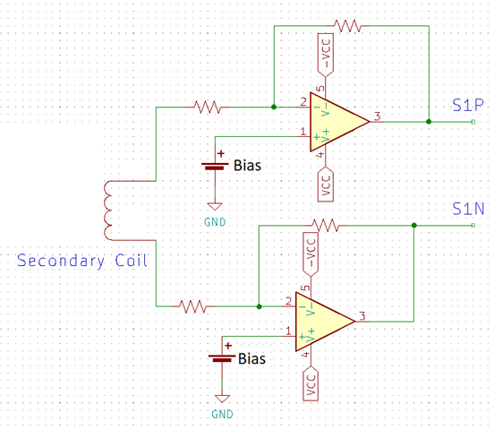

I am designing a board featuring PGA970 to use it with an LVDT. My required Excitation signal is 3Vrms , 5kHz.I have few questions regarding IC.
1) The DAC range is stated to be 1.25V in the data sheet . is this is peak to peak voltage ? Assuming that the gain = 1 , if I take the excitation signal differentially between P1 and P2 will the signal still be 1.25V p-p or will I be able to reach 2.5V ?
Also at the amplification stage if I use 1.67V/V as gain will I get a differential signal of 2.0875 p-p between P1 and P2 or can I get 4.175V p-p ?
2) Regarding the secondary windings at 3Vrms , my LVDT produces 2.312Vrms which is 3.269V peak. Since the ADC range is 0 to 2.5V (peak to peak I think) , this means that I need to attenuate my signal externally before applying it to S1 and S2 ?
3) For the communication with the IC , I am planning to use SPI or adding the connector that matches the connector of USB2ANY in order to be able to use the GUI.
If the communication has been removed will the IC still works (produces excitation signal and produces DAC output voltage) depending on the stored code even when resetting it or does it need constant communication in order for it to keep operating?

    i Noticed the BIAS_VCM_CTRL in the data sheet which according to my understanding could be useful in biasing the bipolar signal to become unipolar within the acceptable range of the Sp1 and Sp2 PINS 0.05 TO 2V. But I guess I still need to attenuate the differential signal before biasing it so I need your reply on the acceptable input range? Are the 0.05V to 2V Peak to peak value of the differential signal from transformer?

  • Hi Amr,
    The relevant requirement for the input signal is the S1 and S2 gain stage input limits, which are a maximum of 2V (single-ended). You will need to make sure the individual single-ended input of each of the S1x and S2x pins are below 2V, which may require some external attenuation. From there, you have noted that the demodulator inputs (the output of the gain stage) needs to be 2.5V peak to peak, so choose your S1/S2 gains accordingly.
    The FRAM program memory is nonvolatile, so once you have stored your firmware in the FRAM it will be saved on powerdown, and start running from the beginning at each powerup.
    Scott

  • Thank you very much for your reply regarding the first 2 points.
    1) For the third point regarding the S1P and S1N inputs , Based on your answer I understood that I need to an external attenuator and also external common mode voltage to shift the signal onto a range from 0.05 to 2V. I think I could use 2 opamps for this purpose in the following configuration. I just need confirmation that it will not affect the input impedance of the IC or anything.
    Note : I am planning to use OPA1656ID from TI.
    2) On the evaluation board there are 47nF capacitor and a 43K resistor that provide decoupling/Attenuation with the internal Resistance of the IC. I think I don't need the 43K Resistor as i already have my signal attenuated but i still need to decouple the signal using the 47nF capacitor? My signal is 5kHz Signal I think the cut off of 47nF is ok for me isn't it ?

    If you only intend to use SPI, there is no need for the extensive OWI circuitry. Just make sure you put some bypass capacitance on the VDD voltage input according to the application diagrams in the datasheet.
    This setup you have included will work well, and the 47nF capacitor should be fine in this application with a 5khz signal.
