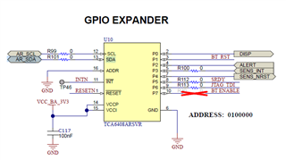

        Do you have picture of your setup? What is the SOP configuration you have used? Are there other boards or peripherals connected to system or I2C bus?
    Are you using MMWAVEICBOOST board for hosting the IWR6843AOPEVM? On this board there are other additional I2C peripherals are present.

       Thanks for sharing the setup details, What application you are running on the AOP EVM?
    For getting the I2C response from the mmWave sensor, you need to run I2C application as a master mode or Slave mode, there are SDK drivers allows this configuration. Typical out of the box demos demos doesn't use the I2C interface, Hence you may not see response from mmWave sensor.  Here’s an example of a somewhat similar exercise by a different customer: link
    If the imp is used as the master and 6843 as the slave, what addresses are you reading to indicate the I2C peripherals? Please note external interface need to be removed during the boot operation otherwise it may interfere with the boot mode of operation.

        Is the demo application code is running correctly on the PC? And only I2C slave configuration is not working?  We need to ensure there is no conflict with the existing I2C devices and it's address.
    For example, In the board there is another I2C device, I2C to GPIO expander with the similar slave address.

  • Changed the address to 0x68, hoping it will not conflict with any other I2C peripheral present on board, but still, it is not working
