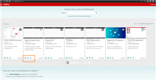

    2. GUI Source Code
    All GUI's on dev.ti.com/gallery can be directly downloaded from that site, see the screenshot below

  • Thanks so much!!
    The item 2 is the answer for me.
    I found a .js file that seems to be the source code. I also found that it seems possible to develop by using TI GUI Composer. However, it seems that patience to read the code is required.
