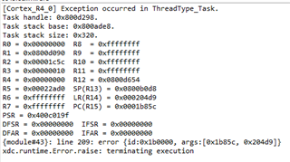

2. Connecting and flashing device via CCS
If I try to flash through CCS, Cortex R4 crashes.

    2. When I checked for CCS debug, MMWAVEICBOOST was connected to the board as seen in the picture.

    2. In CCS, which Out of Box demo did you build (xwr6843ISK or xwr6443?)? If it had a dss and an mss image did you build the dss image first before the mss? Did you get any build warnings or errors?

    2. In CCS, I am not building any demo files. I am trying to connect and flash the pre-built demo files for xwr68xx (mss and dss) in IWR6843ISK

    2. Please try building the dss and the mss projects (in that order) and flashing the resulting bin to the device using uniflash.

    But from suggestion 2 I got CCS debug working which was my main issue.
