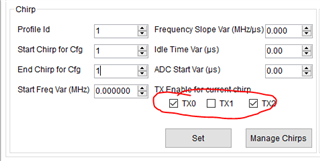

Hi, I am trying Tx beamforming using IWR6843ISK, DCA1000 and mmWaveStudio. I am using 2 tx(Tx0, Tx2)

    [ZY] Yes, you are right,  you will need to wrap any angle to [0,360], and programming the phase shifter value.   But you need to enable all three TX antenna, instead of TX0 and TX2 only.
