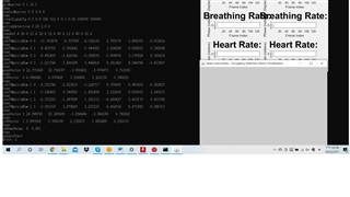

I use the Automotive Toolbox-3.0.0 version and want to modify the example of Occupancy and Vital Sign Detection from detecting two zones to detecting four zones.
I modified the interFrameProcessing in dss_data_path.c correspondingly, and modified the relevant parameters in the .cfg file as follows. But it doesn't work at the moment, can you help me
vod_vital_signs_16xx.rar
%OD Demo commands:
zoneDef 4 20 6 12 6 20 6 32 6 40 6 12 6 40 6 32 6
coeffMatrixRow 0 0 -11.705674 -6.557091 -6.556105 2.793170 2.806355 -0.033616
coeffMatrixRow 0 1 -9.453702 -0.592442 -5.440082 3.204209 -5.838531 0.348308
coeffMatrixRow 0 2 -9.492407 -5.426766 -0.588876 -5.904976 3.170924 0.305614
coeffMatrixRow 0 3 -1.211744 3.400299 3.446914 8.541460 8.544744 -0.413807
meanVector 0 22.771068 22.756197 -3.955602 -3.970473 0.712385
stdVector 0 6.086866 6.070428 3.236808 3.262139 0.348652
coeffMatrixRow 1 0 -4.352746 -2.823618 -3.224717 0.759691 0.487618 -0.582427
coeffMatrixRow 1 1 -7.148465 0.546920 -1.852454 2.332433 -5.030055 2.240273
coeffMatrixRow 1 2 -6.355251 -1.247689 1.201112 -4.680427 2.418175 0.433769
coeffMatrixRow 1 3 -3.381314 2.879600 2.633233 6.402036 6.471842 -0.586713
meanVector 1 24.398743 25.289200 -3.856646 -2.966190 0.782421
stdVector 1 5.997018 5.500159 2.139213 1.685689 0.230110
