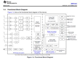

I'm looking for a design guarantee to prove that the second harmonics aren't radiated at high levels.
(second harmonic: 158GHz when IWR1843 outputs 79GHz)
Is there any material such as the K-factor of the output side PA in the figure below?
I understand that these frequencies comply with FCC and ETSI regulations.

  • Hello Ishihara,
    As mentioned in the other e2e thread, we do not have measurements at 160Ghz, but we know its low enough not to cause any serious emission concerns. Could you let us know the reason you are interested in this? Typically your antenna itself would provide lot of attenuation at that frequency.

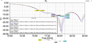

  • Hi Vivek,
    Thank you for kind comments on this.
    We do not have the equipment to observe the Second harmonics band.
    We would like to confirm the spurious characteristics in our antenna design from the test report below and the antenna characteristics of IWR1843BOOST.
    12554995-E2V2 EN 302 264 v2.1.1 AWR1843 Series Final Report.pdf
    Is there any material related to antenna design such as antenna directivity data of 154.197GHz and attenuation by antenna?

  • Hello Ishihara,
    I was referring to antenna data for other bands. We have the antenna gain data only for 76-81Ghz band. For S11 we have data from 70Ghz to 85Ghz. This is shared below.
    Vivek
