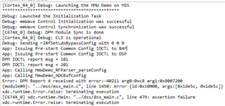

  • Hi Justin,
    I just sent your config with my MMWAVEICBOOST attached in ccsdebug mode and received the following error:
    [C674X_0] xdc.runtime.Main: "../dss/dss_main.c", line 479: assertion failure
    xdc.runtime.Error.raise: terminating execution
    This is a runtime error being caused by a DPM error with code -40211. Here is a thread which details how to read these error codes: https://e2e.ti.com/support/sensors-group/sensors/f/sensors-forum/922019/awr1843-dpm-error-causing-runtime-to-crash
    Thank you,
    Angie
  • Hi Angie,
    Looking up at the error code, the people_counting lab gives back the following error label:
    /** * @brief Error Code:
    Out of L3 RAM during detection matrix allocation. */ #define DPC_OBJDETRANGEHWA_ENOMEM__L3_RAM_DET_MATRIX (DP_ERRNO_OBJDETRANGEHWA_BASE-12)
    In my first post of this thread, I mentioned the possibility of running out of L3 memory as increasing the numADCsamples to 129 + also increases the rangeFFTsize from 128 to 256 Kb (as per [5]). The error message now confirms it, but the computation remains unclear.
    Since we now know the numADCSamples limitation, I can resolve this issue. Thank you for your time
