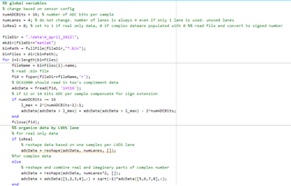

Hi I have a question about processing raw data captured from IWR1443 Boost +DCA1000.
I have used the following configuration and used the matlab example in the following to process them to get the radar cube.
Configuraton
I enabled only the Lane 1 and 2 of LVDS Lane configuration . My question what changes need to be done to process this data in the script provided in Page 15 of https://www.ti.com/lit/an/swra581b/swra581b.pdf?ts=1648885838493&ref_url=https%253A%252F%252Fwww.google.com%252F
I was expecting to see zeros in the files however, I can't see any zeros for the non used lanes. I can p[provide a sample file.
Thanks a lot!

  • Hi Jithendra, thanks for the reply. I think I haven't explained this properly. mmwave studio doesn't show any errors. My problem is how what are changes we have to make to process the data. The script is as follows and the number of lanes is not changed as per the instructions.
    As per the documentation, unused lanes should be filled with zeros, Hower I can't see any zero-filled data after running the code as it is. This is where I suspect I might be doing something wrong. Please advice.
  • Hi Isura,
    Can you confirm that you are getting same file size of adc_data.bin in both case of Lane settings (2 or 4).
    If that is the case, then I think that it doesn't stuff the zero bytes when you reduce only number of lanes (but keeping all other configuration same).
    So you need to process the data with this new understanding.
