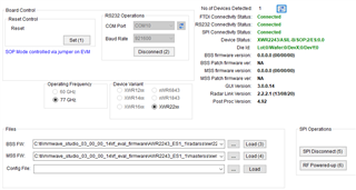

I was using AWR2243Boost and DCA1000EVM with mmWave Studio 3 for capture raw data.
However, I always have this warning "Warning: BSS firmware version Mismatch!"
I believe I used the correct firmware and baud rate.
I used AWR2243Boost Rev A, and the chip was AWR2243P.
I used the firmware here:
C:\\ti\\mmwave_studio_03_00_00_14\\rf_eval_firmware\\AWR2243_ES1_1\\radarss\\xwr22xx_radarss.bin
C:\\ti\\mmwave_studio_03_00_00_14\\rf_eval_firmware\\AWR2243_ES1_1\\masterss\\xwr22xx_masterss.bin
I attached the log file.

[16:47:59]  [RadarAPI]: ar1.Connect(10,921600,1000)
[16:48:01]  [RadarAPI]: Warning: Connected with baudrate 115200
[16:48:02]  [RadarAPI]: Warning: Disconnected existing BaudRate
[16:48:03]  [RadarAPI]: Warning: Trying to connect with baudrate 921600
[16:48:04]  [RadarAPI]: ar1.Calling_IsConnected()
[16:48:05]  [RadarAPI]: ar1.SelectChipVersion("AR1243")
[16:48:05]  [RadarAPI]: Status: Passed
[16:48:05]  [RadarAPI]: ar1.deviceVariantSelection("XWR2243")
[16:48:05]  [RadarAPI]: ar1.frequencyBandSelection("77G")
[16:48:05]  [RadarAPI]: ar1.SelectChipVersion("XWR2243")
[16:48:05]  Device Status : XWR2243/ASIL-B/SOP:2/ES:1.1
[16:48:05]  [RadarAPI]: ar1.SaveSettings('C:\Users\cuiha\AppData\Roaming\RSTD\ar1gui.ini')
[16:48:25]  [RadarAPI]: ar1.DownloadBSSFw("C:\\ti\\mmwave_studio_03_00_00_14\\rf_eval_firmware\\AWR2243_ES1_1\\radarss\\xwr22xx_radarss.bin")
[16:48:26]  [RadarAPI]: Downloading BSS Patch RPRC Binary..
[16:48:26]  [RadarAPI]: ar1.GetBSSFwVersion()
[16:48:26]  [RadarAPI]: BSSFwVersion:(02.02.00.13 (07/03/20))
[16:48:27]  [RadarAPI]: ar1.GetBSSPatchFwVersion()
[16:48:27]  [RadarAPI]: BSSPatchFwVersion:(02.02.02.06 (12/08/20))
[16:48:50]  [RadarAPI]: ar1.DownloadMSSFw("C:\\ti\\mmwave_studio_03_00_00_14\\rf_eval_firmware\\AWR2243_ES1_1\\masterss\\xwr22xx_masterss.bin")
[16:48:50]  [RadarAPI]: Downloading MSS RPRC Binary..
[16:48:53]  [RadarAPI]: ar1.GetMSSFwVersion()
[16:48:53]  [RadarAPI]: MSSFwVersion:(00.00.00.00 (00/00/00))
[16:48:56]  [RadarAPI]: ar1.PowerOn(0, 1000, 0, 0)
[16:48:56]  [RadarAPI]: Status: Passed
[16:48:56]  MSS power up done async event received!
[16:49:02]  [RadarAPI]: ar1.SelectChipVersion("AR1243")
[16:49:02]  [RadarAPI]: Status: Passed
[16:49:02]  [RadarAPI]: ar1.SelectChipVersion("XWR2243")
[16:49:02]  Device Status : XWR2243/ASIL-B/SOP:2/ES:0.0
[16:49:02]  [RadarAPI]: ar1.RfEnable()
[16:49:02]  BSS power up done async event received!
[16:49:02]  [RadarAPI]: ar1.GetMSSFwVersion()
[16:49:02]  [RadarAPI]: MSSFwVersion:(00.00.00.00 (00/00/00))
[16:49:03]  [RadarAPI]: ar1.GetBSSFwVersion()
[16:49:03]  [RadarAPI]: BSSFwVersion:(00.00.00.00 (00/00/00))
[16:49:03]  [RadarAPI]: Warning: BSS firmware version Mismatch!
