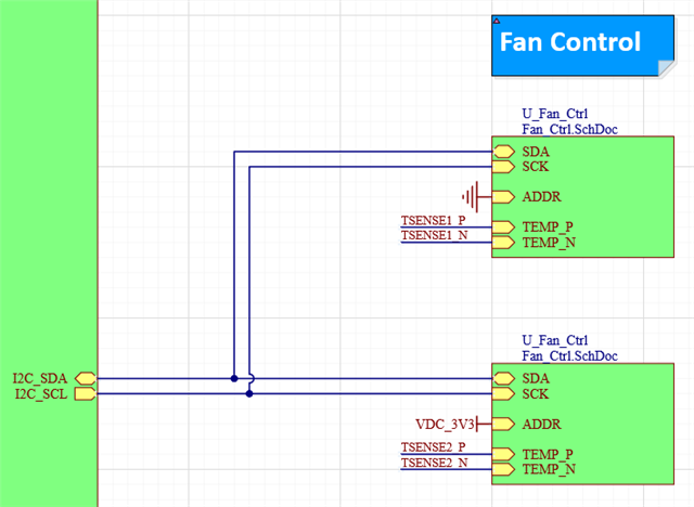

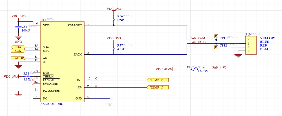

  • Eric -
    What is ADDR connected to? can you whole schematic and also include your pullup resistors? is there more than one AMC6821 connected?
    is there a reason you do not populate your R56, but you did populate R57?
  • There's not much to the rest of the schematic.  ADDR is tied either high or low to address the two AMC6821s.  Inside the left block, the I2C just connects to an STM32 microcontroller's I2C port, with two 4.7k pull-ups to 3.3V.  I'm confident the I2C is working correctly since I can read and write all the other registers and get the expected behavior.
    I DNP'd R56 because the fan we're using (QFR1248GHE-SP01) has an internal pull-up, and populated R57 because the fan tach output is open collector.
  • Eric,
    I'm inclined to believe something is making your AMC6821 hot, and you're just not able to see it with your thermal camera. We're not seeing anything to cause it in your schematic (although maybe there is some 48V path through your fan, whether continuous or transient.) There may still be corruption in the bus result that your logic analyzer is hiding, but it seems unlikely.
    Failing all that, we'd have to call your device(s) faulty and ask for you to return them. How many devices have you observed this on? If all of your devices do it, it's more likely to be a system problem that we're simply not seeing.
