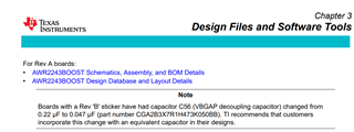

Hi supporter;
I found the description in spruit8d.pdf. But there is no explanation.
We have some MP products used 220nF with VBGAP,so we want to know the impact.
thanks

If you use 220nF cap on VBGAP, there can be issues with booting the device at cold temp (<0C). It is strongly recommended to update to 47nF capacitor to prevent the cold boot issue.

The value of the cap will change the delay in the Bandgap power up and subsequently all the stages of Analog/RF system power up gets delayed. Boot system checks during the power up if these values are not settled to the expected state, then device may not power up correctly.
Using the wrong cap value can cause a complete failure of the system at cold temperatures.
