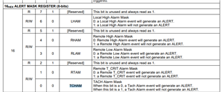

LM96163: How to trigger ALERT pin signal during over Tachometer limit?
Part Number: LM96163
Hi team,
My customer uses this part to do FAN speed monitor but when FAN speed is over Tachometer limit setting but there is no Alert signal output.
Could you advise how to program internal register for correct step?
Based on customer's observation, they found TACH Alarm bit is 1 in REG0x2 and Alert Status' TACH bit is changed. but HW Alert pin is no changed.
