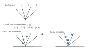

I used subframe configuration for long range detection in OOB demo. (SDK 3.5, Refer to configuration in Long Range People Detection Lab)
These subframes are aiming to focus on the angle of [-33.75, -11.25, 11.25, 33.75].

Q1. Is the output point cloud of each frame/subframe output coordinates with angular focus corrected? Or are the coordinates uncorrected for angles?

    I don't believe there is any correction applied to the pointcloud. The processing will already resolve the angle based on the reflection from the object.
