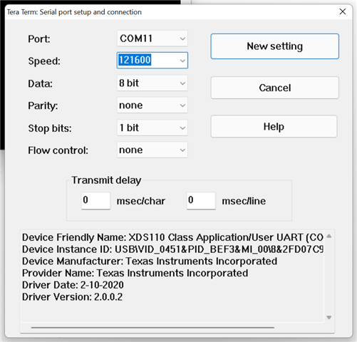

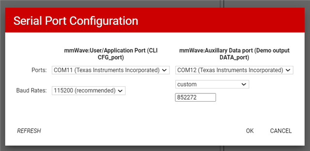

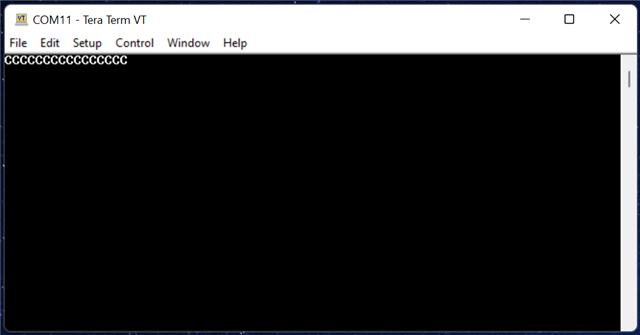

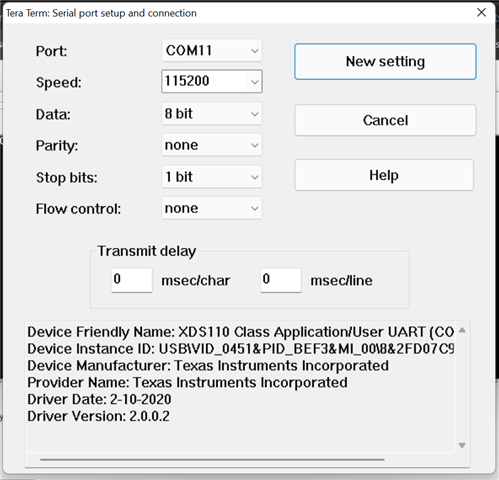

I am trying to run the OOB demo with mmWave Demo Visualizer using AWR2944EVM, however, I have not been able to connect with Application port and Auxillary Data port.
Here is what I have done so far:
1) Installed mmwave_mcuplus_sdk_04_02_00_01
2) Connected EVM to power source, USB and ethernet cable
3) Flashed AWR2944EVM with awr2944_mmw_demoTDM.appimage
4) Attempted to connect with Application port (Baud Rates: 115200) and Auxillary Data port (Baud Rates: 852272) but failed as seen in the pic below (stuck at "Connecting to 1 of 2 targets.")
