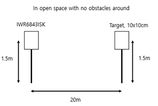

I tested detection performance with OOB demo FW(SDK 3.5) using IWR6843ISK.
The test environment is as follows.
and configuration is below.

The coordinates of the detected cloud point are [0.6, 20.85, 4.76]
I haven't tried RX channel gain/phase compensation yet, but I think the error is too big in z-axis.
An error of 4.7m is calculated as an error of about 13 degrees.
I will buy soon corner reflector for RX channel gain/phase compensation, but are there any considerations other than phase error?
Thanks.
  • Hi Jinhyeong,
    I would recommend purchasing a corner reflector and performing the Range Bias and RX Channel Gain/Phase Measurement and Compensation to calibrate the sensor and compensate for any bias in the range estimation and channel gain/phase imperfections.  Please look at the aforementioned section in the mmWave SDK Doxygen: <INSTALL_LOCATION>/mmwave_sdk_03_05_00_04/packages/ti/demo/xwr64xx/mmw/docs/doxygen/html/index.html
    Please let me know if the issue persists after calibration has been performed.
