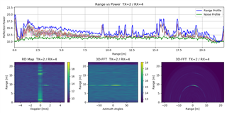

It results in 300 x 32 x 8 x 512
I have two questions.
(1) After radar data processing, I found the moving target was mixed with the range profile (zero-Doppler bin). For example, the moving target is at 10m around. In the Range vs Power plot the moving target was mixed with zero-Doppler bin, which I think it is wrong (1st pic). However, with the TDM setting, moving target was not mixed with zero-Doppler bin, which is correct (2nd pic).
From my understanding, to get the Range vs Power plot Doppler correct is not necessarily applied.
Is there any step that I was missing for BPM decoding so that the moving target mixed with the zero-Doppler bin?

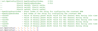

  • Hi Jackson,
    May I have a quick question on ar1.BpmConfig()?
    For my configuration for the 1st chirp both Tx1 and Tx2 has phase 0, for the 2nd chirp, Tx1 has phase 0 and Tx2 has phase 180.
    Here are my configurations.
    Does it look correct to you?
    Thanks!
    Hang
    Yes I think that looks correct. You are correct above, you do not need two chirp profiles, the example just happened to use them. But you do need two chirp configurations to switch the phase of TX2 in the second config. The BPMconfg will only control the demodulation, not the TX output, so you need these to match.
    Jackson
