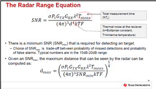

Hi there,
I am using the equation below to compute the SNR
However, I do not know what the value of my transmitter power (Pt in the equation above) is. I am using mmWave Studio. Is there a way to check this in mmWave Studio or to compute it?
