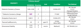

In regard to the antenna design, the substrate properties of rogers3003 didn't match with the substrate property of rogers 3003 datasheets at 77 GHz. Would you kindly explain this?
