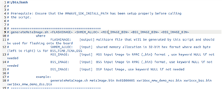

    The .exe files will not work in a linux environment so the post build steps don't work. In the SDK, there is a script provided to run these steps that should work on linux. Please try using the following file and the out files from your CCS build.
    mmwave_sdk_03_05_00_04\packages\scripts\unix\generateMetaimage.sh
    Jackson
  • It seems the file, mmwave_sdk_03_05_00_04\packages\scripts\unix\generateMetaimage.sh requires .bin files of MSS and BSS types.
    However, following are the files generated after building the MSS project
    In such a case what are the arguments to be passed for the generateMetaImage.sh ?
    Thank you.
  • The user's guide for the image generation tools should have this information. Also, you can open the projectspec file to look at the postbuild steps where these values are called.
    You will need the .xer4f file, the .xe674 from the DSS build, and the radarss bin file from the SDK.
