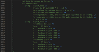

I want to see LUT of Tx and Rx.
Is this correct how to see LUT?
rlRxGainTempLutData_t rxGainTempLutData;
rlRxGainTempLutReadReq_t rxGainTempLutReadCfg;
rxGainTempLutReadCfg.profileIndx = 0;
rxGainTempLutReadCfg.reserved0 = 0;
rxGainTempLutReadCfg.reserved1 = 0;
retVal = rlRxGainTempLutGet(RL_DEVICE_MAP_INTERNAL_BSS, (rlRxGainTempLutReadReq_t*)&rxGainTempLutReadCfg,&rxGainTempLutData);
rlTxGainTempLutData_t txGainTempLutData;
rlTxGainTempLutReadReq_t txGainTempLutReadCfg;
txGainTempLutReadCfg.profileIndx = 0;
txGainTempLutReadCfg.reserved0 = 0;
txGainTempLutReadCfg.reserved1 = 0;
retVal = rlTxGainTempLutGet(RL_DEVICE_MAP_INTERNAL_BSS, (rlTxGainTempLutReadReq_t*)&txGainTempLutReadCfg,&txGainTempLutData);
rxGainTempLutData[0-18] ... 19data ( [degreeC] -30, -20, -10, 0, 10, 20, 30, 40, 50, 60, 70, 80, 90, 100, 110, 120, 130, 140, 140over)
txGainTempLutData[Tx index][0-18]...3*19data ( Tx0, 1, 2 ) * ( [degreeC] -30, -20, -10, 0, 10, 20, 30, 40, 50, 60, 70, 80, 90, 100, 110, 120, 130, 140, 140over)
and if this is correct, for example, how many dB is txGainTempLutData[1][11] = 8 ?
