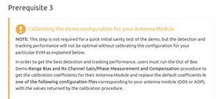

In overhead 3d people counting there's instructions as below:

    I just wanna replicate the overhead 3d people counting demo and the instruction says 'In order to get the best detection and tracking performance, users must run the Out of Box Demo Range Bias and Rx Channel Gain/Phase Measurement and Compensation procedure to get the calibration coefficients for their Antenna Module and replace the default coefficients in one of the following configuration files corresponding to your antenna module (ODS or AOP), with the values returned by the calibration procedure.'
