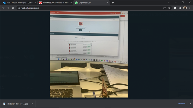

Hello
I am trying to load Vital Signs lab in AWR1443BOOST ES2.0 version but its detecting the board as AWR1642 instead of 1443, when i am trying to flash its showing the header files are not compatible when i manually select the board as 1443 but when i go with automatic detection and flashing on 1642 it is stucking at the downloading metaimage part. I thought it was sdk issue so i degraded to 2.1.0.4 from 3.5.0.4, still the issue persists. Can somebody help me with this?
