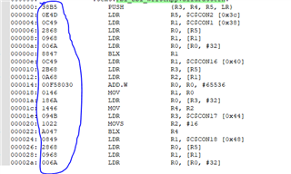

  • Hello
    I did the experiment following is the out come .
    As requested we used armdis --all command and generated the text file below you can see a screen shot from it .
    Image taken from object > text file
    In the 2nd image you can see how data is placed on ram in controller
    so yes there is difference between them , please let me know if you want some more information  .
  • conclusion
    For file_1 which i am compiling with ROM model, the data on ram matches with the generated text file(CHANGE IN ENDIAN)
    But for file_2 which i am compiling with RAM model the data on ram is not matching with generated text file (NO CHANGE IN ENDIAN)
  • Please compare the two builds against each other at the same stage.  Compare the two .out files, the standalone disassembly of those two files, the two hex files, the disassembly view in the debugger for those two files, etc.  At what point in that progression does the mismatch of endianness first appear?  So far, you have not done this analysis.
    I suspect this might be problem of misunderstanding the display.  To show what I mean by that, I’ll give an example.  The only ARM hardware I have on hand has a Cortex-M4F CPU in it.  Your system has a Cortex-R4F CPU in it.  But it appears you build for the Thumb2 code state, which is the only code state supported by Cortex-M4F.  So, as used here in this post, those two CPU's are similar enough.
    Your screen shot shows the beginning of a function.  It starts with two 16-bit instructions.  It is located at an address that is 8-byte aligned.  For a program I am running, I found a function with those same conditions.
    Here is the standalone disassembly view …
    0006cc:              _getarg_diouxp___TI_printfi_nofloat:
    0006cc: 027B             LDRB            R2, [R0, #12]
    0006ce: 702A             CMP             R2, #112
    What order are those 4 bytes as laid out in the .out file?  By methods I don’t show here, I determined that the file offset for the section which contains this code is 0x34 bytes.  So, to see these bytes in the file, start looking at byte offset 0x34 + 0x6cc = 0x700.
    Here is one command to do that …
    % od -Ax -t x1 -w4 -j 0x700 file.out
    000700 02 7b 70 2a
    I load file.out into CCS with the usual load command.  Here is the disassembly view …
    Here is how it looks in a memory browser that is configured to look at 32-bits at once …
    In that same memory browser, change the configuration to look at 8-bits at a time …
    Notice how the order of the bytes does not match.  This code executes correctly, so everything must be correct.  The difference must lie in how these displays are implemented.  I cannot explain how and why these different displays handle endianness differently.  I only know, by direct experimentation, that it works.
    Perhaps your situation can be explained in a similar way.
    Thanks and regards,
    -George
