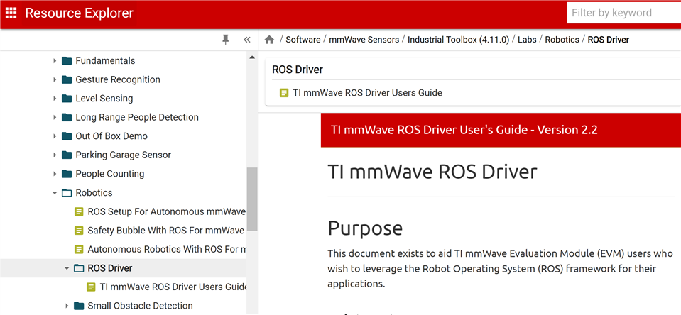

  • Hello Pedrhom
    I am using the ROS driver which I got from the Industrial tool box 4.11.0. The flow is shown in the pic below:
    The launch files are also from the launch folder corresponding to 6843AOP_multi configuration. I didnt flash the sensor with any software as I believe the sensor comes with the default out of the box demo file in it.
    Hope this helps. Let me know if these details are enough.
    thanks
    Vignesh
