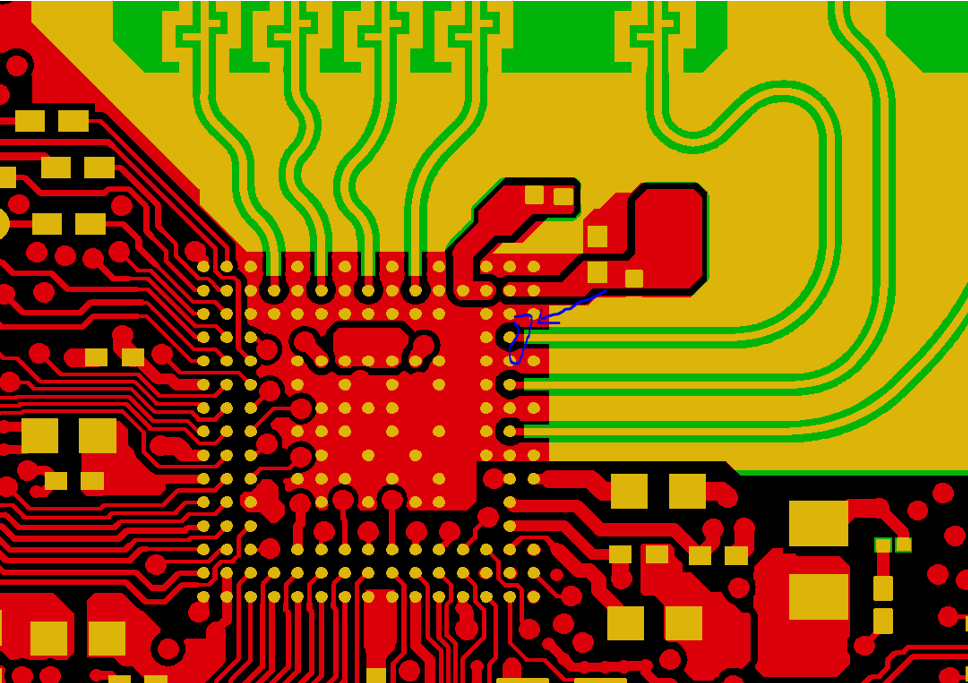

Could you please confirm that tehre is a small area of solder mask between RF IWR BGA balls and RF antenna track ?
(please see blue arrow on picture below  taken from IWR6843ISK eval kit gerber file provided on TI webside : swrc355\xWR6843ISK_DesignFiles\Rev_D).
If confirmered, may this solder mask be a problem for RF track impedance ?
Thanks a lot for your help.
