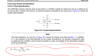

Please tell me how to determine the capacity of the AWR1843 Bost crystal oscillator 100 connected to both ends.
I'm sorry, it's a mistake in the description.
What I wanted to visit was how did you decide the capacity of the capacitor connected to the Y1 crystal?
What does CP refer to in the connection of the clock circuit in the AWR1843 data sheet?
(See data sheet 8.10.2.1)
The load cap is chosen based on the formula provided in the datasheet. Cp refers to the parasitic capacitance from the routing on the PCB.
