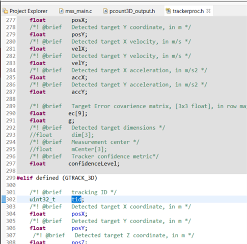

    5) My concern is does the Target Id keep incrementing indefinitely? If I keep sensor on for a long time will target id keep on increasing in value & overflow after long period of time?
    I don't know what will happen if you try to get this to overflow, but you could insert some overflow protection into the code where tracks get assigned to protect against this if it has not already been done. I'd also note that tid (target ID) is a 32 bit integer, so that's not very likely to happen over the course of a product lifetime.
