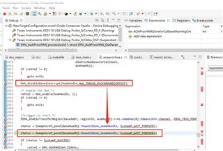

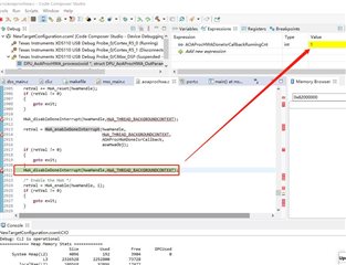

2. Set breakpoints before and after function HWA_enableDoneInterrupt().
   Run the test program, untill hit the breakpoint before HWA_enableDoneInterrupt().
   Figure shown as below. We can find that the AOAProcHWADoneIsrCallbackRunningCnt = 0, which is correct as expected.
breakpoint before func
3. Step over the HWA_enableDoneInterrupt(), hit the 2nd breadpoint after HWA_enableDoneInterrupt().
   Figure shown as below. find that the AOAProcHWADoneIsrCallbackRunningCnt = 1, which is Incorrect as unexpected.
breakpoint after the func
4. Step over a HWA_disableDoneInterrupt(), then still can step over the 1st SemaphoreP_pend(), which means that the semaphore is posted by the ISR indeed.
  While the 2nd SemaphoreP_pend() can not step over, which is corrent as expected.

  • Hi, Cesar:
    We have solved this problem. it's related with the hwa paramset done interrupt mechanism. done interrupt will always be thrown to dss by hwa when finishs, no matter be enabled or not. so when we call the hwa_enableDoneinterrupt(), the callback registed is triggered by prevoius done interrupt that already happened somewhere. it's can be avoided by clearing hwa int status before calling the  enab done interrupt func.
