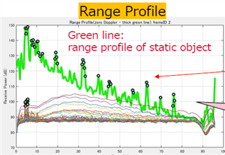

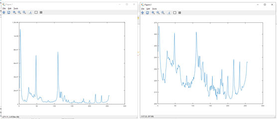

In AWR2243 cascade radar, we have dumped ADC data using TI's default object detection use case radar configuration (35m config). While analyzing the range profile plot, we are observing a U-shaped curve, if plotted in dB. We had collected the data in the general working area facing the room and hence there will be no objects to be detected beyond 15-20m. Please note that this U shape profile is not seen in the Range profile if the amplitude is plotted. It is seen only when the power (10 log) is plotted in dB.
Both plots are shown below for reference:
Fig1 > Range profile with amplitude
Fig2> Same Range profile with power value in dB (10log)
Please let us know if this is an expected profile for long-range or if there is any reasoning behind this.

  • Yes,
    This is the effect of the log function

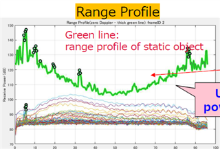

    In Figure 1, the TI's default object detection use case radar configuration is used to configure AWR 2243 with the help of mmwave studio and mmwave studio postproc Matlab script is used to analyze the data. In Figure 2, used TI's cascade_radar_datacollect usecase to collect the data and post-processed using mmwave studio postproc Matlab script.
    The same setup and same radar configuration are giving different results as shown In the below images. In both the plots, we used the log function to plot the range profile in dB. The U-shaped profile is observed only in figure 2. Please let us know why U-shaped profile is observed only in figure 2.
    Figure 1: Used mmwave studio to configure the sensor and plot the data
    Figure 2: Used cascade_radar_datacollect usecase to Capture the RAW ADC data and plotted in mmwave studio

  • Hi Cesar,
    In Method 1 (Figure 1), followed the steps as mentioned in C:\ti\mmwave_studio_02_01_01_00\mmWaveStudio\Scripts\Cascade\Cascade_Capture.lua to configure and capture the raw ADC data using mmwave studio in mmwave cascade EVM. Radar configuration in the Cascade_Capture.lua script was modified according to TI's default object detection use case radar configuration
    In Method 2(Figure 2), captured RAW ADC data with the help of cascade_radar_datacollect use-cases as mentioned below and converted the RAW ADC data format to mmwave studio format to use C:\ti\mmwave_studio_03_00_00_14\mmWaveStudio\PostProc tool to plot the range power profile.
    1. What is the cascade_radar_datacollect ?
    cascade_radar_datacollect use-cases are part of vision_sdk which can be used to dump the raw ADC data into the internal SSD of TDA2x. For more details, I have mentioned the use-cases path below.
    C:\PROCESSOR_SDK_VISION_03_08_00_00\vision_sdk\apps\src\hlos\adas\src\usecases\cascade_radar_datacollect.
    Thanks & Regards
    Vishnu
    Thank you for additional information
    Unfortunately the team that developed the vision sdk demo is no longer available for support. This demo is no longer supported.
    For cascade raw data capture we support only the mmWave Studio method.
