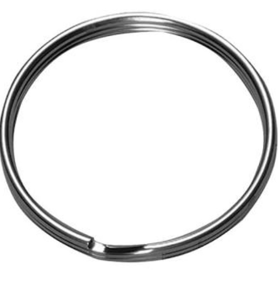

I would like to share an idea how to realize an inductive push button sensing solution above a small OLED display.
In a prototype mockup, it worked well for me with an LDC1614 device, but since then I have not brought it to production status:
The sensing coil was wire-wound around a plexiglass disk, a PCB in form of ring shape might work as well but have not tested it.
The key-element of this construction is the spring between the two plexiglass bodies. Once compressed as far as possible, it will
act as a short-circuit winding, causing cause a huge inductance change in the sensing coil below.
I found this works well and reliable, even with a button-to-sensing coil distance of more than twice the coil diameter.
Hope this could be a useful application for some readers.
Jo

    I did not keep the mechanical stack alive, because the project goal changed in a way that rear mounted displays
    were not required anymore. I recall the following, for the short-circuit winding I have used a key-ring of about 20mm
    in diameter. To make it a compressible spring, it has to be stretched enough- otherwise it would also act as short-
    circuit winding all the time:
    The sensing coils was wire-wound 38 SWG, but I don't remember number of turns and tank frequency (something between 20-30 turns).
    The coil shape was rectangular about 20mm x 30mm, only in provided sketch I have "updated" this to a circular coil.
    One thing to consider, when building this:
    Ironically, it will turn a contactless inductive sensing solution into  non-contactless one, because the compressible spring acts as
    a mechanical switch at the point in time when it is a short-circuit winding. Thus, contact bouncing is something to be dealt with.
    Jo
  • I think picture of spring was missing:
