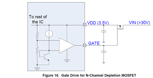

Hi Scott:
And I want to know how the gate driver control the VDD regulated to 3.5V? throw the below picture , when the VGS >VGSth(off),the NMOS is always on state, then the voltate at VDD pin is closely to VIN. how to it become 3.5V?
looking forward to your reply.
thanks and best regards
Kim
Hi Kim,
It's best to ground the GATE pin when the gate driver isn't used to avoid the possibility (although it is quite low) of damage.
At startup, VDD (source) will be briefly close to VIN, the GATE will be low, so VGS will be below the VGHth. The gate driver will then regulate the gate voltage to put VDD at 3.5V
